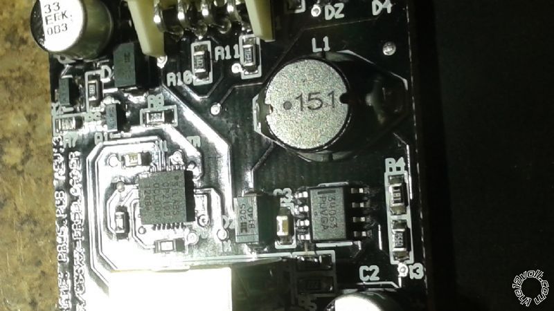

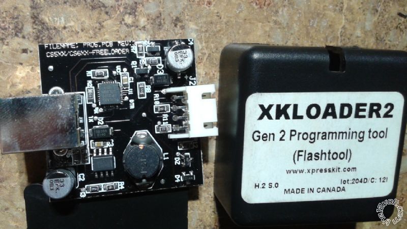

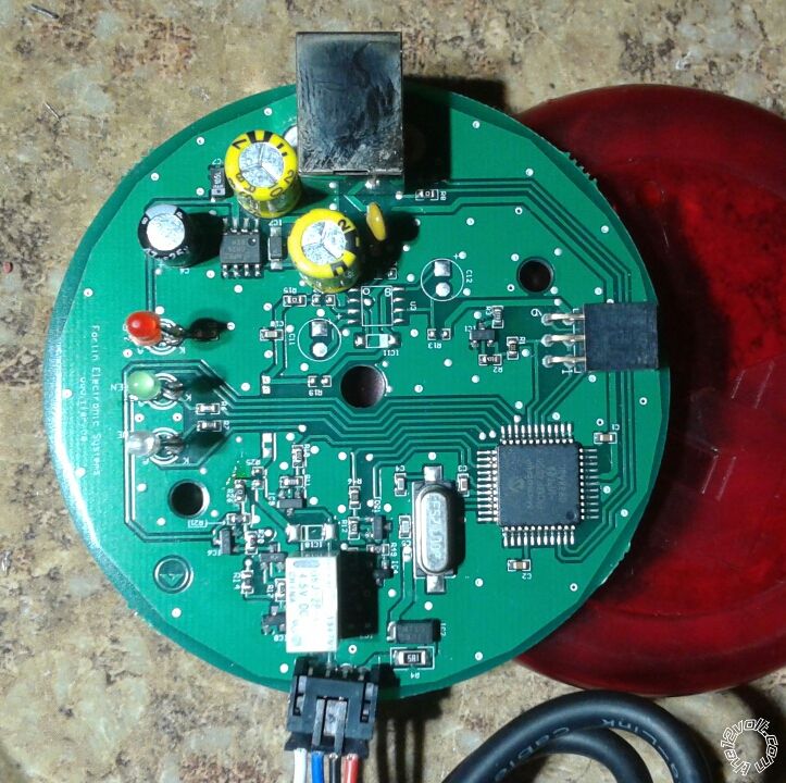

I have never owned Idatalink flash module, but still keep my Fortin and my Xpresskit modules. The Fortin's one is very complicated. It has a microcontroller and am guessing uses custom protocol to comunicate with the bypass modules. The Xpresskit however, contain exactly what you're saying - USB to FTDA chip and 5v to 12V boost up converter, to supply power to the bypass while flashing it. So no surprise if Idatalink is the same from inside, but I can't be sure in that. Yo can buy one of these from the link below with CP2102 and experiment. You need a dealer account with Idatalink in order to flash their modules. I'm not sure why you bother with them at all.
