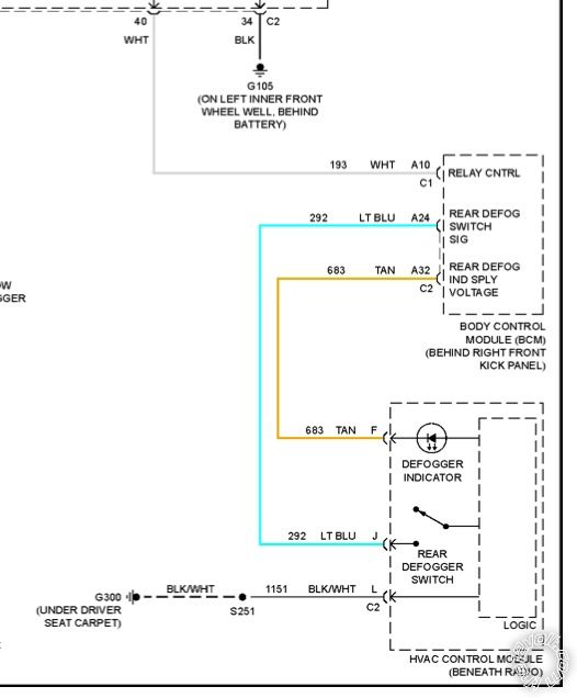

So with regards to the rear defogger, what's the best way to hook that up? Do I go for the wires at the BCM or at the switch? How do i get it to activate? Ground the light blue wire with a relay or something else?
Thanks
Platinum - Posts: 7,828
Posted: September 27, 2014 at 12:19 PM / IP Logged
Don't see too many H3's and have never been requested to add rear defrost.  Here is the info from Omega :
Rear Defrost LT BLUE    AT A/C CONTROL MODULE
You will have to test with a DMM to determine if it is a (+) or (-) signal and if it is latched or a single pulse.  It it is a
(-) signal, with proper programming the Viper can be directly connected to this wire.  If it needs a (+) signal, then a
relay would be required to perform the polarity conversion.
( We can provide DMM testing procedure if needed.)
discodoodie
Member - Posts: 8
Joined: September 18, 2014
Location: Newfoundland, Canada
Posted: September 27, 2014 at 5:58 PM / IP Logged
So I get 12 volts on lt blue whether the rear defogger is on or off. The tan wire get 12 volts when the rear defogger is on. Does this mean that by shorting lt blue to tan with a relay the rear defrost will turn on? I might try it with a jumper wire tomorrow and measure the power at the defogger to see if that works.
hummer h3 2007 viper 4706v idatalink -- posted image.
Posted: September 27, 2014 at 8:03 PM / IP Logged
Assuming that the Light Blue wire is thin gauge and with the "Logic" label on the HVAC Module, I would try this
test procedure before jumping any wires together.
Try this setup with your DMM.
1. Set to 20V DC
2. Red test lead to +12V constant source.
3. Black test lead to the Light Blue wire.
This will check for (-) logic signals using reverse logic.  The DMM Red test lead has +12V on it and the Black test
lead is "looking" for a path to chassis ground.  When found the DMM will display the +12V signal.
If the Light Blue wire is a (-) signal wire, you will see 0V with the engine running and the Defroster OFF.  When you
turn the Defroster ON, the DMM should go to +12V.  If the +12V is momentary ( or just while the Defrost button is
depressed ) it is a pulse signal.  If the signal remains at +12V during the entire time the Defroster is ON, then it is
a latched signal.
I would expect a latched signal with the relay shown.  If this tests as a (-) latched signal you can program the Viper
Menu 3, Item 11 to Option 2 and connect the H/3 BLUE/WHITE (-) 200mA 2ND STATUS /REAR DEFOGGER OUTPUT.
