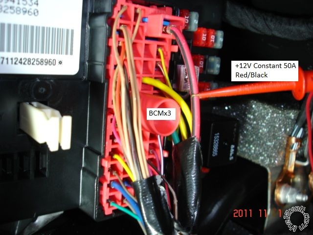

What 12 volt wires do I need to power up on the viper 4204v since I am only using one ignition and Accessory output??? I do not have the install manual here...Thanks
Platinum - Posts: 7,828
Posted: October 06, 2014 at 3:44 PM / IP Logged
H1/1 Red, H3/5 Red & H3/8 RED / Black.

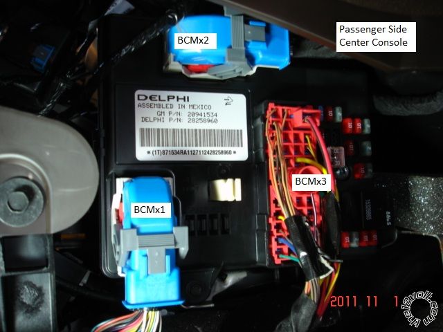

Great!!!!! thanks....I am assuming I can get all of the wires for remote start right at the BCM in the center consel?
Posted: October 06, 2014 at 6:03 PM / IP Logged
Yes.  That photo is the BCM as viewed from the passenger side of the console.  Most of the wires are right there.
08 malibu 4204v viper -- posted image.
I usually get the ignition wires & Passlock at the ignition switch connector and the J1850 Data at the OBD2 plug.
