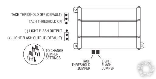

If you verified the Green w/Siler dot (+) Parking Light wire with a DMM, did you ensure the Viper's Internal Jumper is set to (+) position?

Hey kreg357, how do I set the vipers internal jumper to (+)?

Posted: October 10, 2014 at 11:23 AM / IP Logged
The programming jumpers. Page 34 of the installation manual or reference the image below.
viper 791xv won't remote start -- posted image.

Never mind... Found it in the booklet after 10 min lol
lowriderman234
Member - Posts: 12
Joined: December 30, 2013
Posted: October 10, 2014 at 11:40 AM / IP Logged
Thank you for the picture though!
