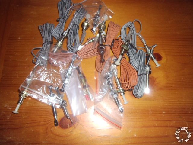

Perhaps the more direct way is easiest.  Install a separate pin switch in the trunk for the Viper alarm and leave the vehicle wiring alone.  The rust issues should be less in the trunk environment. I have a pot full of the hood pin switches that are included in most R/S kits ( I use mercury switches if the vehicle doesn't have a viable hood pin switch ).  I can send you a couple.  08 crown vic issues -- posted image.   Leftovers from recent installs...
