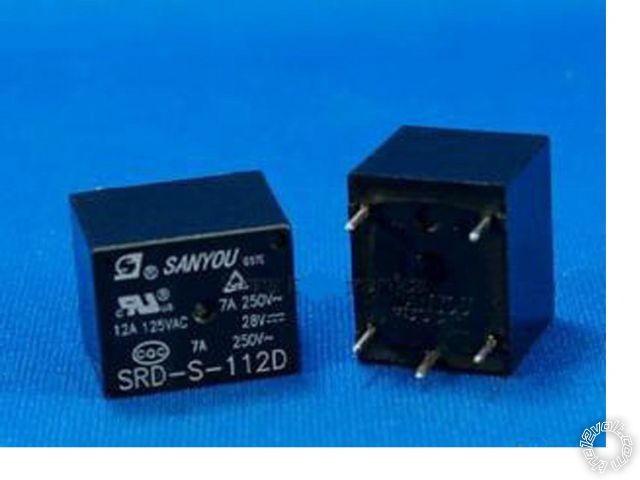

Platinum - Posts: 7,828
Posted: October 11, 2014 at 2:55 PM / IP Logged
Yes, just follow the diagram wiring and it will work fine.  For diagram expediency they reversed the Pin 85 and 86 inputs on the left ( lock ) relay.
The most common & generally available relay is rated at 30/40 Amps and will work fine for your application.  You could get away with 10 Amp relays, if you had some available.  I use 10 Amp mini-relays for those circuits.  Either way, fuse the +12V supply input at 10 Amps.
remote start door lock -- posted image.
