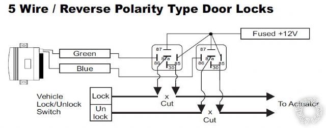

I have a 1995 f150 that im adding power door locks to. the door locks came out of a explorer so they are two wire locks. The f150 has no alarm system installed. So I need to know how to wire relays for the locks to work. Im using a 6 post momentum switch to lock and unlock the doors now so my install works perfect. Just need to know how to wire the relays. Thanks shawn.

Apply the diagram below to your existing setup.
door locks, two wire actuators -- posted image.

now that's just what I needed, thanks a million. thanks shawn

I tried that diagram and it will not work. Theres no place to hook the ground or it does not reverse it for lock/unlock. Any other ideas?

So your system doesn't rest at ground? Do you have a schematic for your setup?
Personally, if the system doesn't rest at ground I would rewire the whole system to use only 2 relays but the 4-wire reversal will work in your system using 4 relays
https://www.the12volt.com/doorlocks/page3.asp#4w
