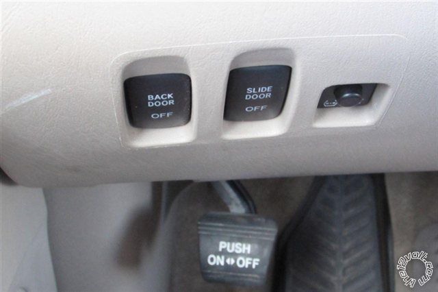

If you didn't plug the sliding door disable switch back in on the dash, the remotes nor the buttons wouldn't work. Or it could be as simple as the switch being pushed to disable the sliding door.
2006 toyota sienna sliding door -- posted image.

Flobee4 and Dman007 the problem was the slide door switch off very simple thank you both
