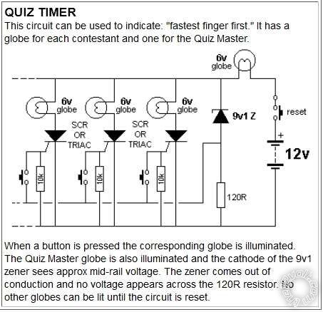

Google (two button) quiz circuits. I suggest viewing Images.
Maybe the simplest is from electronicdesignworks.com reflex action game; namely:
relays for game button circuit -- posted image.
Usually they use SCRs as per the Quiz Timer circuit at zaleski.org's from 101-200 Transistor circuits.pdf - ie:

S1 turns on T1 which illuminates L1.
T1 turning on raises p to a higher voltage (maybe 5V) hence if S2 is pressed, p is too far above 0V (GND) to turn on T2. T1 & T2 are PNP transistors which need their Base thru S1 & R2 or S2 & R1 to a reasonably more negative voltage than their Emitter (to +6V via S3) to turn on.
Maybe I'm wrong else he's confused the circuit sides, but either way, it should be easy to check during testing or swap leads after assembling.
