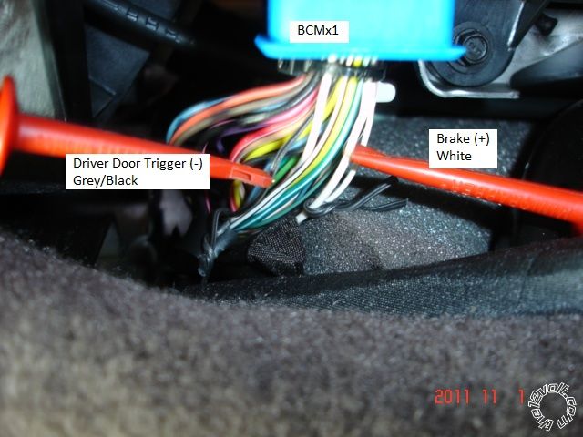

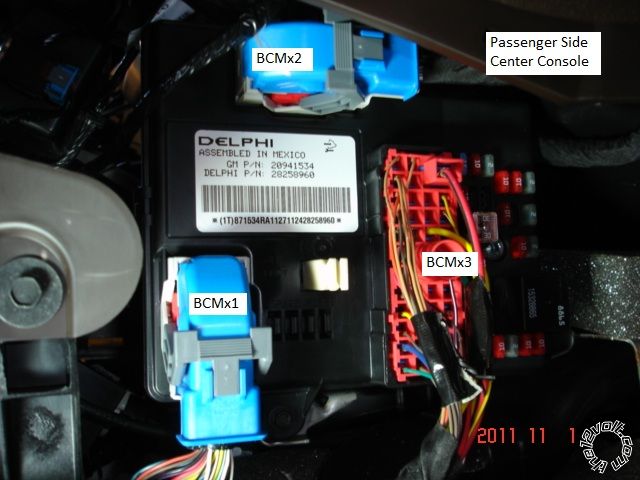

i am installing viper 4806v and i need to identify the wire behind the kick panel for the driver door switch.please help.
thank you
1616884422
Platinum - Posts: 7,828
Posted: November 14, 2014 at 10:09 PM / IP Logged
Are you looking for the Drivers Door Pin wire?  If so, it is a Gray/Black (-) wire and can be found here :
DOOR TRIGGER     GRAY/BLACK (-)      @ BCM, GRAY 72-PIN PLUG(X1), PIN 51

Thank You for taking the time out to be helpful, it's appreciated.
1616884422
mediaman
Member - Posts: 21
Joined: November 05, 2014
Posted: November 26, 2014 at 12:35 AM / IP Logged
I completed the installation , Thank You to all that helped.
