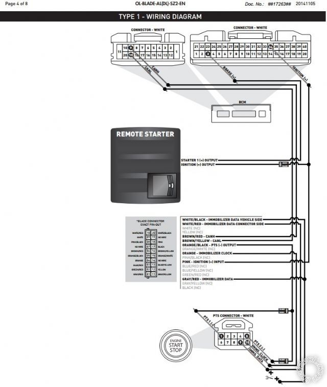

I'm looking to do a remote start install on a 2010 Suzuki Kizashi. Am I missing anything to get this up and going? Also have a few questions below.
On remote start unit:
6 PIN MAIN:
Red & RED / White - 12V
Pink - Ignition +
Violet - Starter +
Orange - Accessory + ( I need this for heat/ac to turn on correct? )
18 PIN SECONDARY:
Black - Ground
BROWN / Red - Brake + (Can i wire this to Starter + ?)
BLACK/ White - Neutral Safety -
Violet/ White - Tach Signal (I dont know where to splice in for this, guide says fuel injector??)
Brown - Siren ( I need this for tach learn?)
This is the guide for the blade..
excalibur + blade remote start -- posted image.

All you have to hook up is what's shown in the diagram.
Plus your power ground parking lights.
The blade does the rest.
