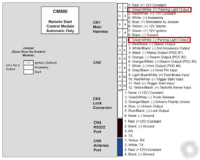

At the moment, I've got the parking lights to work but when I connect the first parking light connection (+) the fuse blows up, but when I leave that disconnected and only plug in the parking light (-) the fuse does not blow and the lights work.
Does that mean that from the compustar brain, I only need one of the two (parking light + or - ) to be connected to my car's parking light + or - ) to get it working?
Attached is one screenshot from compustar's brain2003 acura 1.7el remote starter -- posted image.
From CN1 (GREEN / WHITE --> (+) Parking light) When connected the fuse blows and parking lights and remote start do NOT work.
From CN2 (GREEN / WHITE --> (-) Parking Light output) When connected, fuse does NOT blow and parking lights and remote start work.
Please advise if I need to have both or just one of the wires connected to my car.

Yes, you only need and should make only one Parking Light connection to the car. Either (+) or (-), whichever is easier, but not both. They do go to different wires in the car. You must match polarity.
