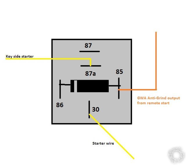

Posted: November 21, 2014 at 10:51 AM / IP Logged
Is this right?
avital anti-grind? -- posted image.

You are close.
Pin 86 should go to the pink (+) ignition wire in the ignition harness.
So wiring would be:
85: Anti Grind from Remote start (can also use Ground When Running from Remote start).
86: (+) Ignition signal.
Cut start wire in ignition harness.
87A: Key side of cut starter wire.
30: Motor side of cut starter wire.
Cheers.

I thought those cars had antigrind built in
naten34
Joined: November 17, 2014
Posted: November 23, 2014 at 3:01 AM / IP Logged
Got it working. Thanks for your help guys!
Yes it does. I wired up the anti-grind relay and had everything ready.....then I read your post. Tried it. Turns out it won't grind the starter with the key or with remote start either.
So for future people that may install this into a related GM car: THIS CAR DOES NOT NEED AN ANTI-GRIND RELAY.
