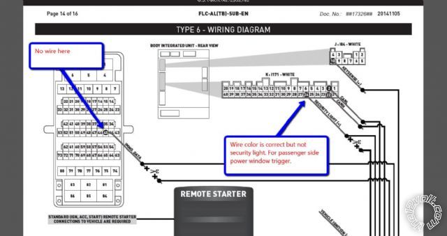

The Flashlogic wiring information is incorrect for the 2015 Subaru Legacy. The attached file shows my situation. The IMMO Data wire is not there and the security light wire is incorrect. Can anyone lead me to the correct wires or on how to test the IMMO wire?

I've given up on using flash logic on a newer subaru last 2 I did nothing matched and finally just did a key in box

I am having the same issue......no immo data wire there.... did you get this vehicle done?

usually the bcm/biu are upside down, while in the guide its other way around.

so i just finished the install, i went straight to the ecu on the passenger side, lower plug, pin 38 Data Bus - WHITE/ blue

so i just finished the install, i went straight to the ecu on the passenger side, lower plug, pin 38 Data Bus - WHITE/ blue , on pzev vehicles there is NO wire at the plug on the tech sheet from idatalink. You need to go straight to the ecu on pass side engine compartment.
