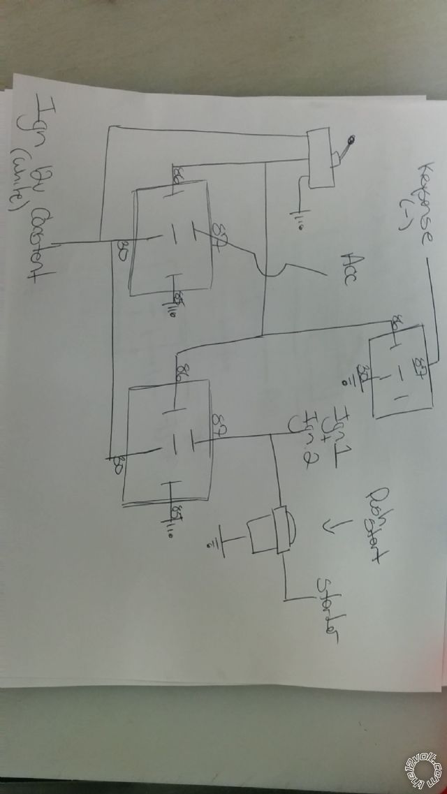

okay so i have a 2004 honda accord sedan ex-l
im trying to add a push to start button with toggle switchs for ignition..
2004 accord ignition toggle switch -- posted image.
this is my diagram of what i think i should do.
the only problem is that the acc doesnt turn on..
if i put the key in and turn it to acc and flip the switch everything else will work.
im not focusing in the push to start i understand i need a bypass for it to work, but will i need a bypass for the whole project entirely?
can someone one tell me what im doing wrong please..

There is 2 accessories and one ignition.
Maybe because you only used one relay to power your so called ignition 1 and 2.
Ignition is BLACK / YELLOW.
Accessory 1 is BLACK/ red
Accessory 2 is white /red.
Add another relay and keep everything isolated.
Just my 2 cents
