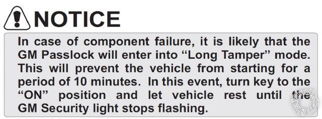

I think you're right. Just came across this from the installation pdf.
remote sometime starts -- posted image.
