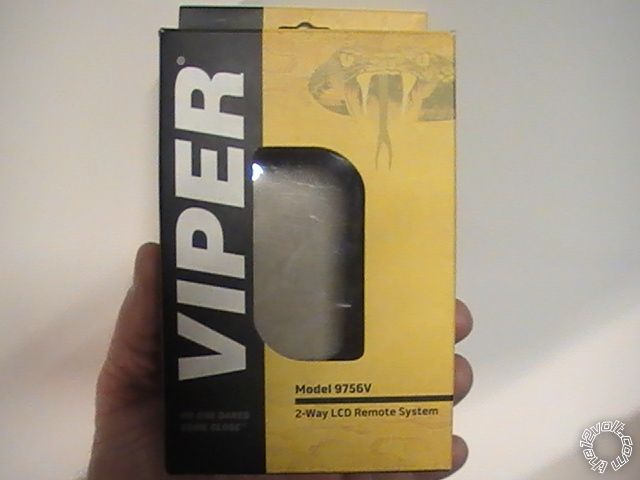

viper installer giving questionable info - Page 2 -- posted image.
Which antenna do you have on your car. Probably on the windshield.
smokeman1
Platinum - Posts: 1,589
Joined: September 14, 2009
Posted: November 26, 2014 at 9:51 PM / IP Logged
These are all two way remotes and the matching antennas. The set on the left is from a Viper 4204 system with a "UP 2000 foot" range. The set on the right is from the kit shown in one of the photos stating a "Up to one mile range". I have installed a 4204 with the kit containing the set up on the right, giving me a "UP TO" one mile range.
But you must have a matching antenna and remote.
I have interchanged all of these antennas on a 4204 remote start.
Notice the difference between the center LCD remote and the LCD remote on the right. These remotes must be matched and paired with the compatible antenna. They can not be mixed.
I think your installer has made your 4606 into a 4806, but you should have been informed of it prior to install. Just my opinion.
