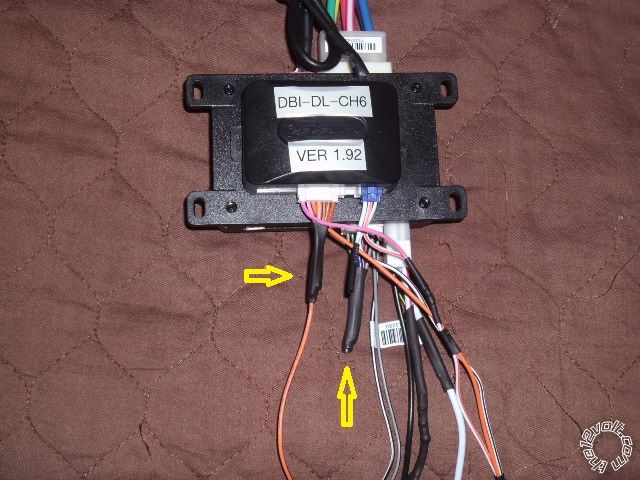

I cut the un-used wires at about 2.5 inches, then use various diameter heatshrink tube to bundle them into groups at each connector.  I keep a bag full of these trimmed wires handy in case I need to re-attach any that were cut at a later date.  This bag of wires came in handy yesterday.  It seems almost every wire was too short to get from the R/S assy to the vehicle wires on a 2003 Mountaineer install.  Must have lengthened 10 different wires to reach.
Here is bench prepped R/S assy for a Jeep G.C.install on Friday.
what to do with extra wire? -- posted image.
Couldn't help it K exactly what I normally do I only changed to my first post after having to do the big D2D to W2W change around.
