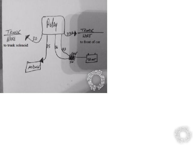

09 corolla rear defogger/ trunk pop - Page 2 -- posted image.
thespinman82
Member - Posts: 25
Joined: November 25, 2014
Posted: December 06, 2014 at 11:13 AM / IP Logged
Would that pic be correct??

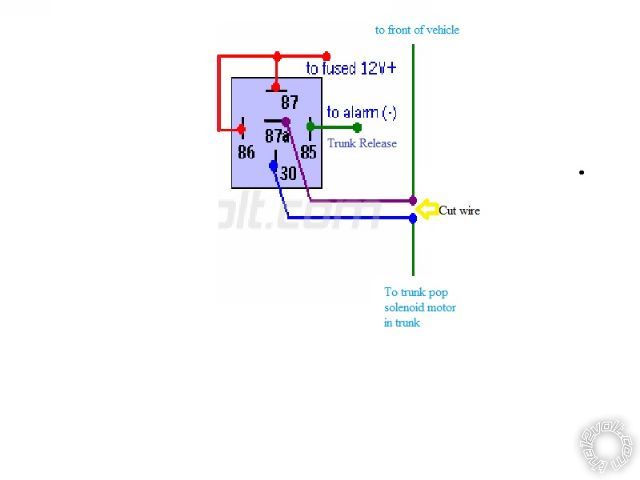

Platinum - Posts: 7,828
Posted: December 06, 2014 at 11:27 AM / IP Logged
Yes, but the cut vehicle trunk solenoid wires must be connected to specific relay terminals.  The vehicle trunk solenoid wire side that goes to the trunk solenoid is connected to Pin 30.  The side of the wire that comes from the front of the car goes to Pin 87a.

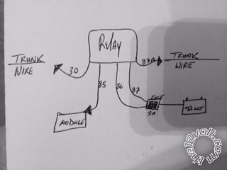

same as this :
