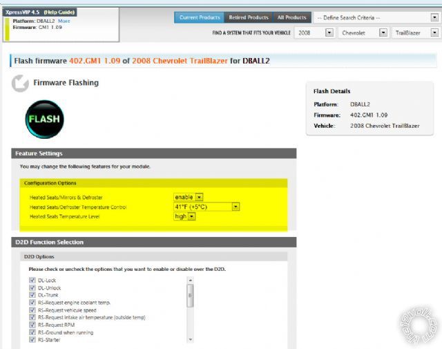

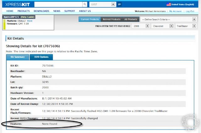

Here is an update to this issue.
After flashing the DBALL2 multiple times, when I unplug and then plug it back in and it detects the current flash and says the seats are enabled @ +5 degrees the way I had it set. However, if I click the 'More' link under Features it does NOT display the heated seats option and still does not work. Also, is it possible that I may have to energize that circuit using the Satellite harness to the Brown ACC wire? That seems like a roundabout way to do it and therefore would not be controlled by the DBALL2.
tempermental dball2 -- posted image.

Last update. The seats and rear defrost are working now. Apparently the multiple flashes did the trick and I guess it just wasn't cold enough when I tested. Not sure where it pulls the temperature from, I figured the same sensor that tells you the outside temp but they weren't coming on when the temp was 30 degrees (seats set to come on at 40). It was 12 degrees today and they came on.

Sometimes the trick is to flash the first time with all settings cleared, then flash again with the desired settings.
