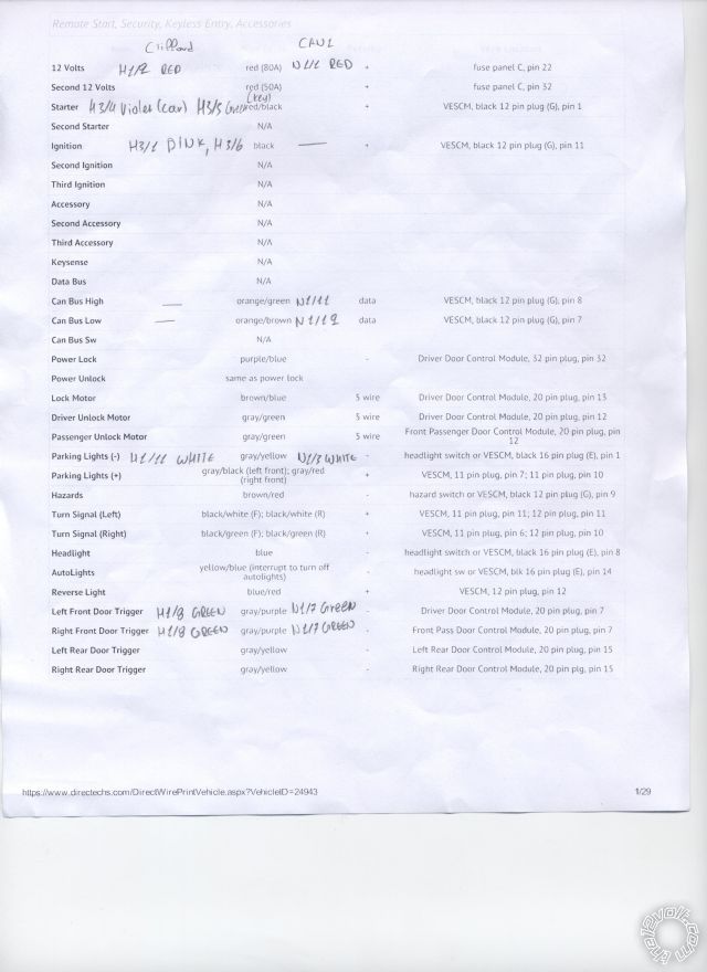

CAN1 Wiring's

I managed yesterday to figure out that only 4 wires from CAN1 will be connected directly to the car (RED 12v, Black-Ground, CAN-H and CAN-L) and every other cables will be connect pin-to-pin with the harness of Clifford 50.7x.
For example:
Clifford Harness(H1)  CAN1 Harness(N1)
H1/1(RED / WHT)TRUNK REL OUTPUT 200mA
(This will be connected to N4 harness(N4/1 RED / white) of CAN1 module , but also here a relay is needed?)
H1/2(RED)(+)12V CONSTANT - N1/1(RED) 12V CONSTANT
H1/3(BROWN) (+) SIREN
H1/4 -
H1/5(BLACK) GROUND     - N1/2(BLACK) GROUND
H1/6 -
H1/7(BLUE)TRUNK PIN/INST TRIGGER INPUT- N1/8(BLUE)TRUNK STATUS OUTPUT
H1/8(GREEN)DOOR TRIGGER INPUT      -    N1/7(GREEN)DOOR STATUS OUTPUT
H1/9(BLK/WHT)DOMELIGHT OUTPUT 200mA - N1/5(BLK/WHT)DOMELIGHT INPUT
(i must use a relay here in order to drive the output dome light into the dome light input of the CAN1 or i will connect wire to wire?)
H1/10(WHT/BLUE)REMOTE START ACTIVATION-
H1/11(WHITE)PARKING LIGHTS OUTPUT(-) - N1/3(WHITE)PARK LIGHTS INPUT
H1/12 -
The N1/6(Yellow) (+) Ignition Status Output will be connected to Heavy Gauge H3/1 PINK or it will be disconected?
