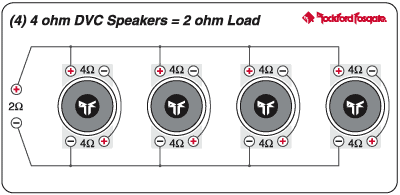

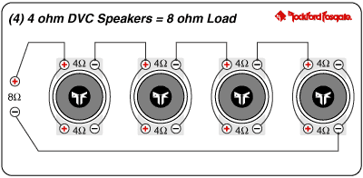

I have them wired at .25 ohm rite now. I want to move it up to 1 ohm. I have 4 dual voic coil 4 ohm subs. I want them to al run together on my Soundstream Class A 10.0

or anything higher than .25 If I cant get 1 can I get .50

I found wiring diagrams for 2ohm or 8ohms.
How do I wire my 4 SPL 10s for 1 Ohm -- posted image.
