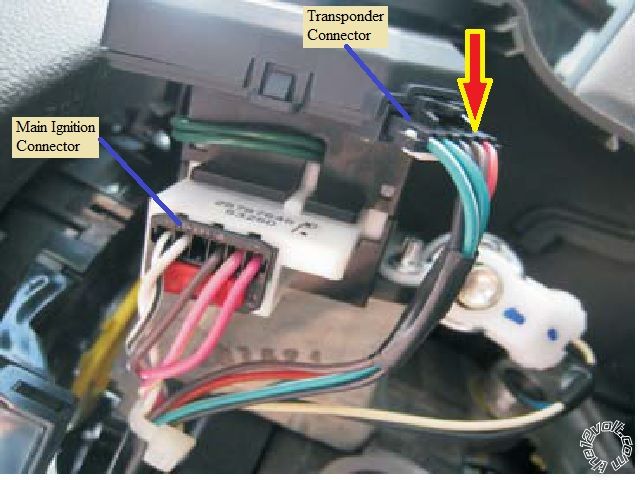

Ready to install 4113 with one button remote with DLPK bypass and RFLCHGM on 08 Impala LT. Only want remote start. will use car fob for lock/unlock arm/disarm.
Here is what I believe the way I should wire it but not clear in several wiring areas.

Pink "accessory" does this go to Heavy gauge conn pin 4?
yellow "R code" to ignition switch white wire?
WHITE/ black to vehicle but where?

Lt. green Data to transponder conn green wire?
Brown V ref. to ignition connector WHITE/ blk?

That goes to the transponder connector side of the cut Brown ACC wire.  Here is a link to the DLPK install guide :
https://www.directechs.com/DocumentDownload.aspx?d=7314&p=122&f=1632
4113 and dlpk on 08 impala -- posted image.
