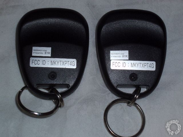

Ok, now about FCC ID. You said FCC number I have should work. I don't know what number I have. I ordered MKYTXPT4G but label was wiped so I couldn't say its exactly what I ordered.
Quick search gave me that remote in this shape may have two FCC ID: MKYTXPT4G and MKYMT9207TX. The 1st one operates on 434Mhz and the 2nd on 310Mhz.
Also I found that 3 types of board can be in this remote: TXPT4-I (I got like this one), TXPT4P (recently also got just board like this one. It has 433 crystal oscillator so I assume it works on 434Mhz) and 3rd type of board TXPT4-L.
I tried both boards of remotes I have and both can't be learned to the U1270TL system. But as I said I don't know exact FCC ID that boards.

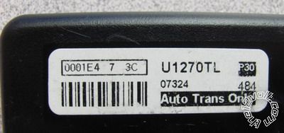

Interesting.  I still have a N.I.B. U1270TL on the shelf.  This one is the later U1270A-TL models.  The TL designation means that
it can run in the TachLess mode, while the older model had to have a tach signal connected and learned to remote start the
vehicle.  Here is a photo of the white sticker on the bottom of the controller :
ultra start u1270tl fcc id? -- posted image.

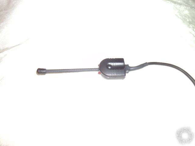

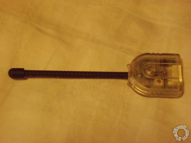

While the original U1270's come with the solid black plastic antenna with the twin Red LED's, this one has the newer clear
antenna with the twin hyper Blue LED's.
Here is a photo of the older style antenna :

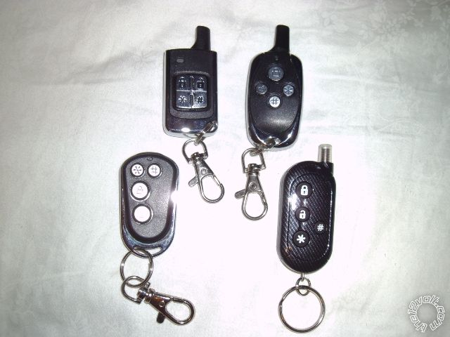

The two remotes included in the kit look like this ( the older ones have a Red LED, while the newer ones have a Blue LED ) :
And have this FCC sticker on the back :
I have used many different style remotes interchangeably on the basic U127x AM freq controllers.

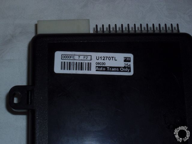

Ok, I have the same label on the brain module as yours - U1270TL.

And I have Antenna module in clear plastic case with two blue LEDs as you said for TL model.

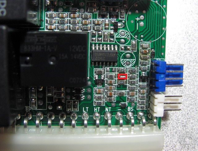

Also can you please check for me one resistor on main board? I marked it with red. (between 10k and 27k, and between 10k and 6.8Mom). I believe it should be something between 100k and 500k.
I had another project last summer and soldered out that resistor and now of course don't remember what it was. On board it goes to the op amplifier (LP2902) and it's in Ignition circuit. Anyway system responds as should when I set ignition key to On position. But anyway I want to solder back correct resistor.

The resistor at that location has the 3 digit resistance code on it of 104, so it's a 100,000 resistor.  For what it's worth, the
other resistors in the positions adjacent have the same values as the ones shown in your photo, so the PCB's are similar.
