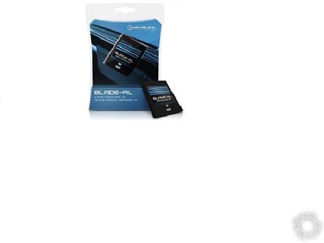

DL stands for Door Lock,
TB stands for Transponder Bypass.
Ugh...
I can't flash one kind of module to another can I? Is the Blade configurable to be a TB of DL interface?

The Blade AL is a cartridge that slides into a docking port of the CM7200.   Looks like this :
confirm 2007 subaru outback and cm7200? -- posted image.
You should use that for the DL firmware ( convenience,locks, etc ).
The ADS AL CA will be flashed with the TB SUB firmware.  The white sticker on the box indicates the firmware that was flashed at the factory.  Hopefully, the seller flashed the correct firmware for you but no one ever updates those white stickers.  Remember that for Subaru's, bypassing the transponder is a KLON process that requires the ADS USB cable again.  Here is a link to the install guide (See Page 15 for the steps ) :  http://cdncontent2.idatalink.com/corporate/Content/Manuals/TB-SUB/ADS-AL(TB)-SUB-EN_20141211.pdf

Yup, I know what the blade is :)
I did a bunch more reading today through all the manuals and constructed an Excel chart of what I needed. I got all the other wires connected up and all the status lights are showing a happy, healthy system. I programmed my remote up (a w901ss) and the locks work great!
