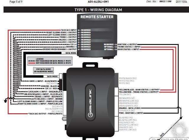

I got a excalibur RS-450-EDP+ remote starter and a idatalink ADS-AL(DL)-GM1 it is going in 2002 Chevy Impala. I think I have all wiring ready to go just wish someone could look it over and give fix anything before I wire up in car.
The one thing I don't know about is from the guide from Idatalink it shows IGNITION (+) OUTPUT from remote starter to idatalink PINK IGITION (+) INPUT. Do I tie into the large ignition #1 wire from the 6 pin harness or is there another wire I use for this.

"The one thing I don't know about is from the guide from Idatalink it shows IGNITION (+) OUTPUT from remote starter to
use for this.
You can just connect the iDatalink Pink IGN input wire to the RS-450 thick Pink IGN wire at the 6 Pin Main Harness.  This
thick Pink wire continues to the Impala's IGN wire for the connection.
There are two Red +12V Constant wires in the ignition switch harness, so split the R/S load between the available
power wires.

Looks like you are going W2W.  You mentioned connecting the iDatalink GWR wire so I'm sure you also connected the
Red to +12V constant and the Black to Chassis Ground in that same plug.  Remember to set the iDatalink Installation
Mode to Standard ( 2 blink pattern ) and lock it in prior to vehicle programming.  Everything else looks good.
Here is a link to a Pictorial on that vehicle:  https://www.the12volt.com/installbay/forum_posts.asp?tid=131509

"Blue Wire - Ignition (-) Output connect to Idatalink GWR (-) INPUT – blue/white wire    *** Blue wire default is (-) Status"
I just want to make sure I understand you on this. Do I connect the blue/white wire from Idatalink GWR (-) input to the 3 pin satellite relay harness (Blue wire) or to the 14 pin harness (white blue wire)?
Here are the descriptions from RS install guide
3 pin harness:
(Blue Wire) - Ignition (-) Output
This provides a 250mA negative output that mimics the large PINK ignition wire’s
operation. However, it’s operation is programmable. See installer feature #6 for other
options.
CONNECTION: This is typically used to activate immobilizer bypass modules. Connect
it directly to the module’s activation input.
14 pin harness
(WHITE/ Blue Wire) - Remote Start Activation (-) Input
This input will activate the system’s remote start function when it receives a negative
pulse. Another pulse during remote start operation will turn off the remote start.
CONNECTION: Connect this wire to any device that you desire to activate the
remote start feature. It requires a negative pulse input.

For the iDatalink's (-) GWR Input you want a R/S output wire that provides a (-) output just slightly before the R/S
system starts to turn on the ignition wires.  The RS450 EDP+ install guide I found,
( http://www.wiresheet.com/v2/install_guides/Excalibur/RS-450-EDP%20PLUS.pdf ), had this label on that Blue wire :
Status (-) Programmable Output - BLUE      and this Installer Feature Programming information :
6    Sat. Port Blue Wire Function Status    Ignition       Going by this info, it looks like the default is Status
and the correct type of signal to be used by the iDatalink module as its' GWR input.  The other possibility for the GWR
wire is the Orange wire on the 14 Pin harness labeled "Status / Anti-grind (-) Output".
The other wire you mentioned, (WHITE/ Blue Wire) - Remote Start Activation (-) Input is a R/S input signal.  It is used to
initiate a R/S.  A single or series of (-) inputs on this wire will kick-off a remote start.  The install guide is not very
informative about this wire or the actual number is (-) inputs it needs.  It might be programmable with Installer Feature 1
to 1, 2, 3 or 4 pulses.    I don't use Omega R/S systems so I can't be 100% positive.
