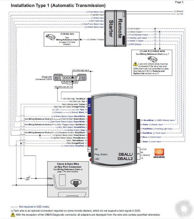

I've got a Viper Responder One that's sitting in a box because I can't get a response from Directed about this (Viper or Xpresskit)
Nissan 09 install and it lists a required wire in D2D as ignition input from the starter to ignition input and output on the bypass module. There is nothing listed as ignition input, what do i use?
responder one problem -- posted image. responder one problem -- posted image.

It's your pink responder output
