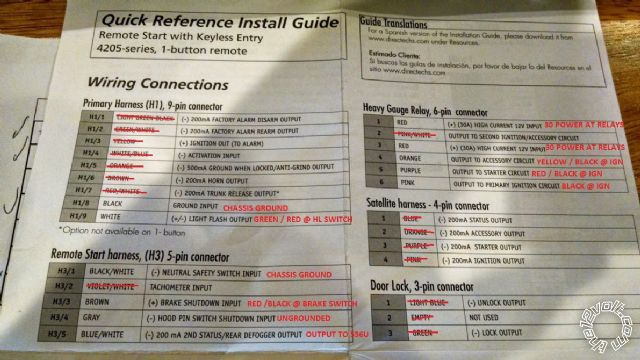

Viper 4205v will not make any output to start 2002 VW Passat. When remote button is pressed there is no response of any sort from vehicle and failed red led and beep sound from 2 way remote. The diagnostic flash code is 7 flashes. As per the supplied manual 7 flashes is (-) Neutral safety shutdown (H3/1 Black / White). I have verified the Black / White wire is properly grounded but still receive the same 7 flash fault code.
Current setup is:
2002 passat / viper 4205v no response. -- posted image.
What else am I missing that needs to be addressed? This is a bare bones install gone wrong. Thanks in advance!

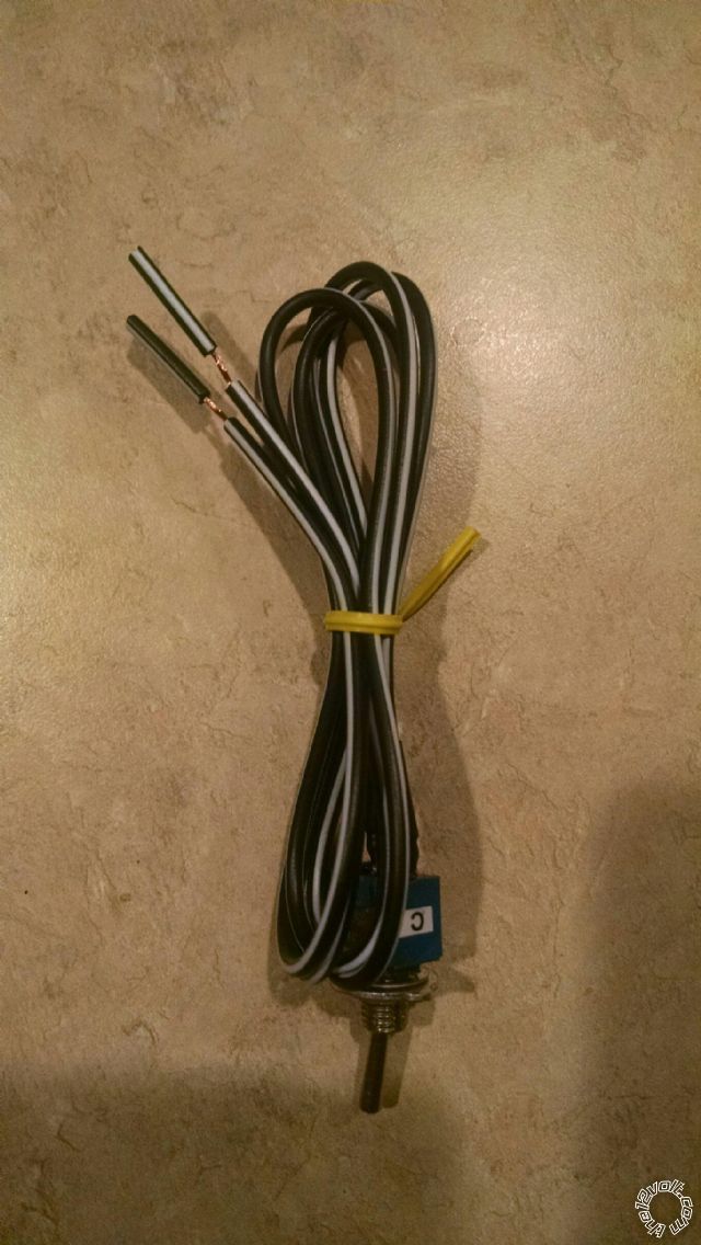

The kit did not come with a plug in style switch. It came with this switch that appears to go inline with the neutral safety circuit based on the color.2002 passat / viper 4205v no response. -- posted image.
Posted: January 13, 2015 at 7:47 AM / IP Logged
That switch isn't needed if your NSS wire either goes to ground, auto or parking brake switch, manual. Please refer to my previous post, you still haven't told us whether the vehicle is a manual or an auto, don't tell us, we can't tell you.

Are you getting ignition lights?
Yes? Install by-pass.
No? Test voltage from Viper side of input fuses to your grounding points.
Try remote start and see if you're getting voltage at the violet, orange, pink at H3.
Your H3 BTW is wrong
