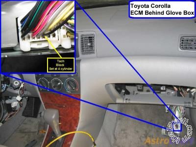

On the 05 Toyota is the black tach wire present at the OBD2 plug?Thanks
vane0804
Member - Posts: 40
Joined: November 15, 2007
Posted: January 13, 2015 at 8:28 AM / IP Logged
black (except XRS models) (ac) ECM behind glove box, far left white 31 pin plug, pin 5
05 corolla tach -- posted image.
