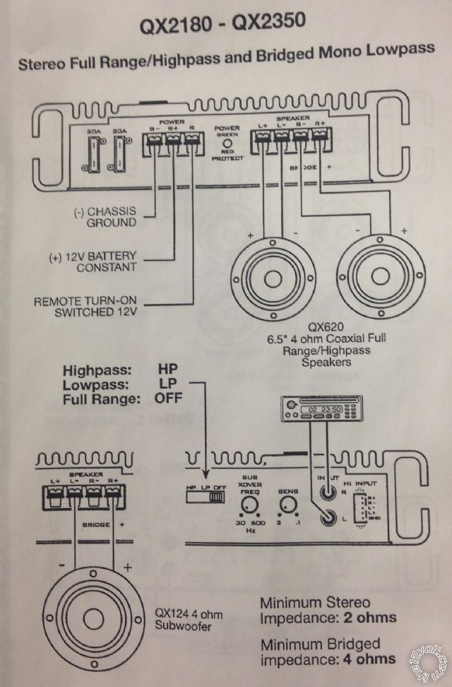

Hello,
I recently installed a new headunit and am now trying to use an external amplifier to power the stock subwoofer. I have a Phoenix Gold QX 2180 that I’ve had lying around for 10 years. It was my first amplifier and I thought it would be easy to just wire it up considering I already have all the cables necessary.
My problem now is this...I’ve just found that it is only 4 Ohm stable (at a Minimum in Bridged Mode) so I can’t bridge the connection for this sub. I see from the specs that the Amp is fine in 2 Ohm Stereo Mode.
My question is this...Can I hook up the stock 2 Ohm subwoofer to a single channel on the stereo setting (either Left +/- OR Right +/-) and leave the second channel empty and run it fine? I would have the LP option on and set the x-over frequency? What will this do to my sub? Or will that not work? Is it safe?

Attached is a picture of the connections page of the manual.
98 Lexus ES300, Trying to Use Stock Sub -- posted image.
