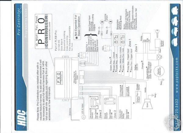

I'm not a really good DIY, but given enough info, direction and maybe drawings. I can figure it out. I agree with your thinking regarding a timed relay just incase the valve limit switch failed. I do have schematics. I scanned them and can post the picture if I figure how to attach or post it.
bach939
Member - Posts: 7
Joined: February 12, 2015
Posted: February 14, 2015 at 9:56 AM / IP Logged Link to Post Post Reply Quote bach939
adding additional accessory to door locking -- posted image.

Hi Jim, I would start with the output wires used to lock and unlock the actuators. The Pro controller has 3 separate output legs, 2 wires each coming out of the 6 wire plug. Each pair has ground at rest and one wire out of the pair has about a 1/2 second of 12 volt positive when you lock and unlock the system.    Start by testing these outputs with your ball valve to see if its possible. The other option is a more complicated relay. Thank you, Chad
Great info and instructions. And thanks for the drawing too!
Here is the info I got from the manufacturer of the door locking system regarding triggers wires. Don't know if you need it, but here it is if you do.
Hi Jim,
system.
Thank you,
Chad
