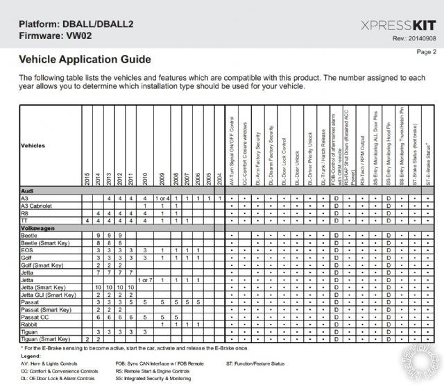

I'm trying to remote start audi TT 2014
I already installed them and door lock/unlock works fine but won't remote start.
When I press remote start IGN turns on. and I see the message "SAFE" in instruments cluster.
Is this mean Immobilizer bypass is not working?
I refer to following installation manual
https://www.directechs.com/DocumentDownload.aspx?d=9514&p=461&f=11881
and take Installation Type 4 - Regular Key for TT
for Immo I used method3.
I really appreciate your help. thank you.

dball2 repeat flashing orange and red during remote start..
I'v made a ring around key cylinder and key fob with awg30 wire.
idatalink manual shows to use AWG30.
and I also tried with dball2 original wire. yellow/red and BROWN / red.
remote start is still not working.

Posted: February 15, 2015 at 5:42 AM / IP Logged
Where did you get Type 4?
It should be 1a or 1b.
Posted: February 15, 2015 at 5:50 AM / IP Logged
Erratum it should be 1B
Every Audi, Seat, Skoda and Golf based VW uses it since about 06.
OP please read the DB-ALL instructions again.
Done loads, all the same it's the one application where the DB-ALL 2 is better than the competition.

I'm using viper 4706V
>1) Are you getting shutdown diagnostics?
I did shutdown diagnostics using viper control module, led lights 4 times, It seems I have Immobilizer problem.
>2) Try it with a key in the ignition.
yes I did, but car won't start.
I also tried other method of Immo bypass.
I got Installation type from Installation manual.
Viper 4706v and Dball2 Remote Start Problem -- posted image.
I couldn't find 1a or 1b.
When I remote start, DBALL2 LED will blink red and orange continuously.
Thanks
Posted: February 17, 2015 at 7:44 AM / IP Logged
Go to Xpresskit and wire it following European section, type 1b.
