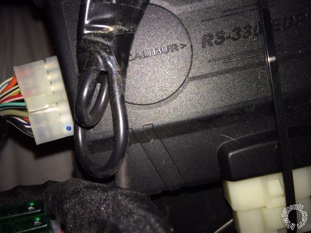

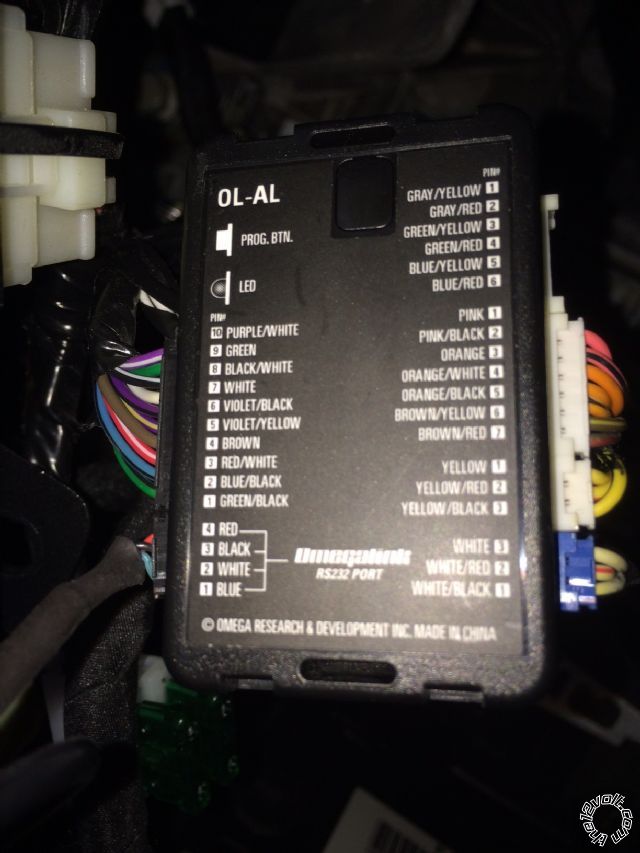

unit pics:
2011 traverse excalibur rs-330-edp / ol rs232 -- posted image.

Problem is unit does not have the valet switch. Can I use the program button on the rs232 module?

they probably didnt install the antenna because they were using the OEM remotes,your gonna have to buy a remote kit that comes with an antenna to do it.

I am going to look at it again and see if there is a plug where the switch goes. This would be the blue port on the RS330 module right?

the blue 2 pin port on thr RS33O is correct.
