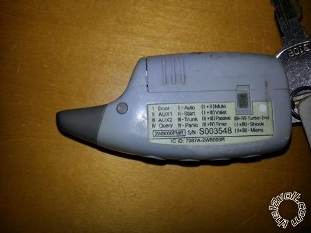

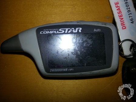

are you able to post the picture of the remote? Want to make sure you have the right part

Posted: February 24, 2015 at 11:32 AM / IP Logged Link to Post Post Reply Quote melaniev
Here's the pics of my remote.
Just want to clarify...so the RF-2W703R-SH is a remote and antenna kit that I can just swap out for our system?
Thanks again!!!
Thanks again!!!
That is correct. the RF2W703SH-CN is the model you want to look for. The 704SH from the states runs on a different frequency good for 1500ft.
When you get your new kit, you will have to change the antenna + program the new remotes. No need to tinker with the wiring under the dash. It's a simple 1plug remove/replace/reprogram
