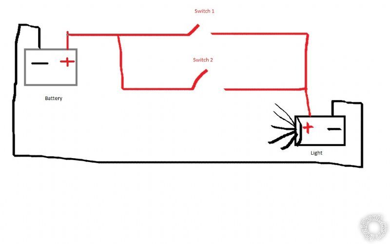

Two positives to one accessory? -- posted image.
Here's my attempt at a basic diagram. I infer from the responses that this diagram would pose no problems if wired up exactly like this, as the power source is just the battery to both switches, and by closing the two switches there is no issue created when the currents going through each of the switches "rejoin" when it hits the light.
If, however, I introduce a different power source (say tapping into an ACC wire like the cigarette lighter or tapping into the brake light wire), it would still be OK using each switch separately, but a diode would be needed to keep the power streams separate if both switches could be turned on at the same time. If no diode was used, then is the only "bad' thing that happens that the battery power would go into the brake light postive wire and turn on the brake light?
(Note, I am not proposing to wire something this way, just trying to understand a basic element of 12VDC power.)

As shown in your diagram there is no problem - they are simply 2 switches in parallel.
If you power switch 2 from another source whether another battery or ACC or brake etc then you interconnect both sources/supplies when BOTH switches are closed.
If you can do that without unacceptable consequences then fine. Otherwise you need diode isolation. (EG to stop the brake light coming on when switch 1 is closed, or powering your IGN or ACC when both switches are closed; or interconnecting 2 batteries (which may be ok) etc.
Diode isolation is fine provided the load(s) are fine with the diode voltage drop (typically 0.3V to 0.7V depending on the diode for low currents) AND the diode can handle the load - ie, a single 23W stop lamp requires a 2A diode (hence use a 3A diode) whilst two 23W bulbs require a 5A diode.
