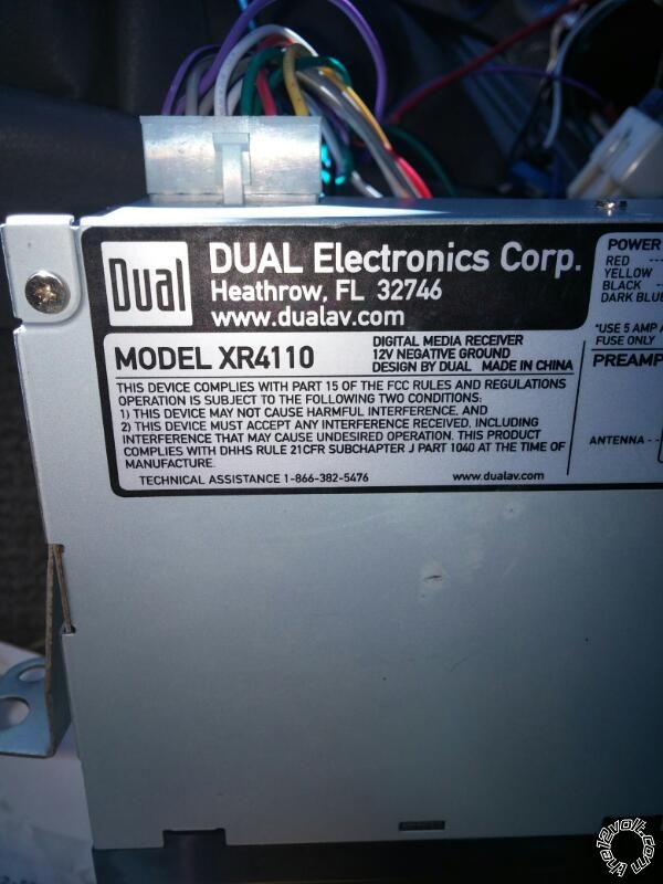

Ok I took everything apart today.the strange thing is I unplug the harness from the back of the head unit to check voltage. Everything checks out. Plug it back in and it works just fine. Starting to think this head unit may crap out after it heats up??95 4runner Radio works in aux, but not on -- posted image.
