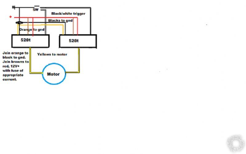

I basically want a motor to open and close a chicken door on a timer with a 12 volt setup
Posted: April 04, 2015 at 12:17 PM / IP Logged Link to Post Post Reply Quote howie ll
Use the above circuit or use 2 ready made timers from DEI, 528t:-
The switch is an SPCO, or momentary centre off, this will give you one touch open and close.
