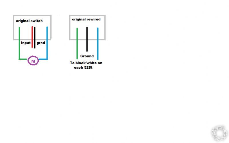

howie ll wrote:
You need a momentary centre off SPCO (aka SPDT) as I explained a above. A single push button won't do it. You'd need two. If your existing switch is spring loaded centre off, i.e. momentary action, like a window switch then remove the power supply feed it from ground, remove the existing ground the outputs then feed the 2 X 528t.
I see. So like a center off momentary rocker switch, correct?
Posted: April 03, 2015 at 11:24 AM / IP Logged Link to Post Post Reply Quote howie ll
Exactly.
swedespeed7
Member - Posts: 8
Joined: April 03, 2015
Posted: April 03, 2015 at 11:25 AM / IP Logged Link to Post Post Reply Quote swedespeed7
howie ll wrote:
Exactly.
Thank you very much for your help!
Posted: April 03, 2015 at 11:43 AM / IP Logged Link to Post Post Reply Quote howie ll
Here's a stylised diagram of how to rewire your existing switch, this makes it one touch either way. As I said before, this is how mirror folds and effectively one windows work.
Disconnect 12 V+ supply and rewire to the 528t's and ground (s), reconnect ground to 12V+ terminal, send outputs (originally to motor) to each 528t.:-

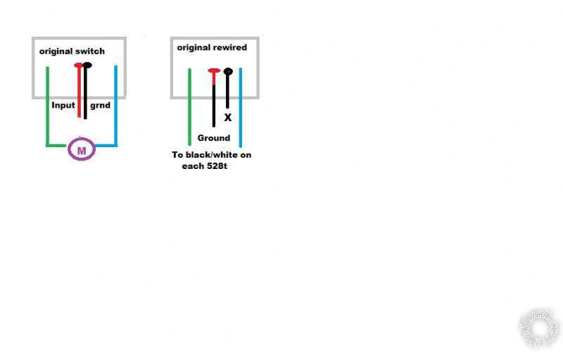

Posted: April 03, 2015 at 11:54 AM / IP Logged Link to Post Post Reply Quote howie ll
I've redone that diagram to make what you have to do more obvious:- 2EF_switch_mods.png
