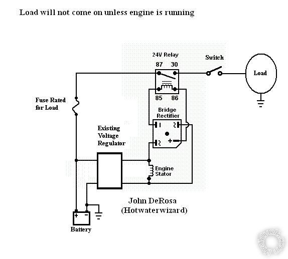

Posted: April 28, 2015 at 8:40 PM / IP Logged Link to Post Post Reply Quote hotwaterwizard
We do this on Hot water Pressure Washers all the time so the burner does not come on unless the engine is running. On only after engine has started -- posted image.
John DeRosa (Hotwaterwizard)
