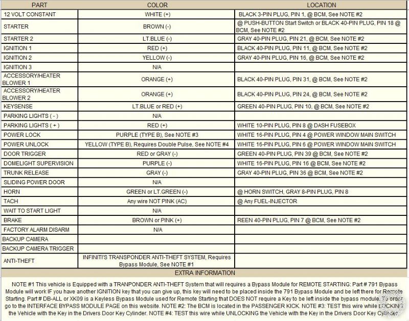

I am looking for wiring codes for a 2007-2008 G35 Sedan:
Specifically the lead(s) for the backup camera and the trigger to turn the camera/screen on.
For anyone else looking for wire colors and triggers, here is what I have as of now.
 PART       COLOR      LOCATION
 12 VOLT CONSTANT       WHITE (+)       BLACK 3-PIN PLUG, PIN 1, @ BCM, See NOTE #2
 STARTER      BROWN (-)      @ PUSH-BUTTON Start Switch or BLACK 40-PIN PLUG, PIN 18 @ BCM, See NOTE #2
 STARTER 2      LT.BLUE (-)      GRAY 40-PIN PLUG, PIN 21, @ BCM, See NOTE #2
 IGNITION 1      RED (+)      BLACK 40-PIN PLUG, PIN 11, @ BCM, See NOTE #2
 IGNITION 2      YELLOW (-)      GRAY 40-PIN PLUG, PIN 16, @ BCM, See NOTE #2
 IGNITION 3      N/A
 ACCESSORY /HEATER BLOWER 1      ORANGE (+)      BLACK 40-PIN PLUG, PIN 31, @ BCM, See NOTE #2
 ACCESSORY /HEATER BLOWER 2      ORANGE (+)      BLACK 40-PIN PLUG, PIN 24, @ BCM, See NOTE #2
 KEYSENSE      LT.BLUE or RED (+)      GREEN 40-PIN PLUG, PIN 10, @ BCM, See NOTE #2
 PARKING LIGHTS ( - )      N/A
 PARKING LIGHTS ( + )      RED (+)      WHITE 10-PIN PLUG, PIN 8 @ DASH FUSEBOX
 POWER LOCK      PURPLE (TYPE B), See NOTE #3      WHITE 16-PIN PLUG, PIN 4 @ POWER WINDOW MAIN SWITCH
 POWER UNLOCK      YELLOW (TYPE B), Requires Double Pulse, See NOTE #4      WHITE 16-PIN PLUG, PIN 6 @ POWER WINDOW MAIN SWITCH
 DOOR TRIGGER      RED or GRAY (-)      GREEN 40-PIN PLUG, PIN 39 @ BCM, See NOTE #2
 DOMELIGHT SUPERVISION      PURPLE (-)      WHITE 16-PIN PLUG, PIN 16 @ BCM, See NOTE #2
 TRUNK RELEASE      GRAY (-)      GRAY 40-PIN PLUG, PIN 36 @ BCM, See NOTE #2
 SLIDING POWER DOOR      N/A
 HORN      GREEN or LT.GREEN (-)      @ HORN SWITCH, GRAY 8-PIN PLUG, PIN 8
 TACH      Any wire NOT PINK (AC)      @ Any FUEL-INJECTOR
 WAIT TO START LIGHT      N/A
 BRAKE      BROWN or PINK (+)      REEN 40-PIN PLUG, PIN 7 @ BCM, See NOTE #2
 FACTORY ALARM DISARM       N/A
 ANTI-THEFT      INFINITI'S TRANSPONDER ANTI-THEFT SYSTEM, Requires Bypass Module, See NOTE #1
 EXTRA INFORMATION
 NOTE #1 This vehicle is Equipped with a TRANPONDER ANTI-THEFT System that will requires a Bypass Module for REMOTE STARTING: Part # 791 Bypass Module will work IF you have another IGNITION key that you can give up, this key will need to be placed inside the 791 Bypass Module and be left there for Remote Starting. Part # DB-ALL or XK09 is a Keyless Bypass Module used for Remote Starting that DOES NOT require a Key to be left inside the bypass module. To order go to the INTERFACE BYPASS MODULE PAGE on this website. NOTE #2: The BCM is located in the PASSENGER KICK. NOTE #3: TEST this wire while LOCKING the Vehicle with the Key in the Drivers Door Key Cylinder. NOTE #4: TEST this wire while UNLOCKING the Vehicle with the Key in the Drivers Door Key Cylinder.
2007-2008 G35 Sedan Wiring -- posted image.
