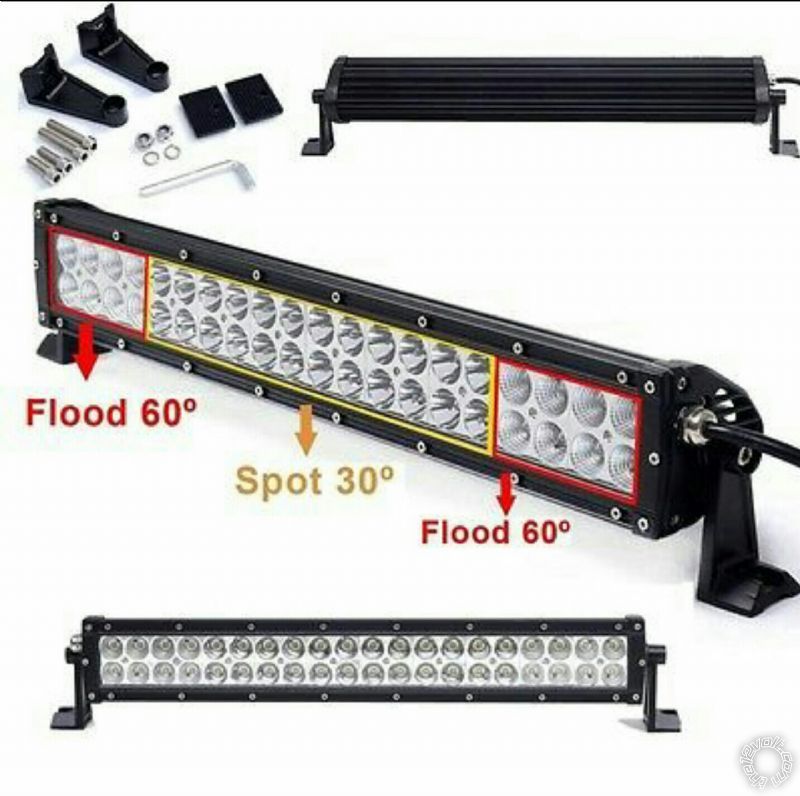

I am trying to use a led light strip for use in my trade show booth and was wondering what type of power supply I would need in order to run it off of an AC to DC power supply? Here are the specs for each of the led strips with a picture of the strip as well. There is a total of 4 that I would be using. Would I be able to run each of these on a 12v 5a or 12v 10a? What would be best.
Material: Diecast Aluminum Housing
Voltage :10-30V DC
Power: 120W 8000LM(40PCS×3W LED Taiwan Epistar Chip)LED Strip for indoor use -- posted image.

Power = Current*Voltage
I = P/V = 120 W / 12 Volts = 10 Amps
