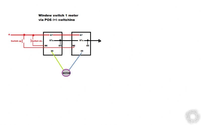

OK this is how I assume they're wired:- pos_relay_window_switch.png

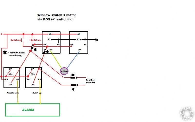

This shows you what to do:-

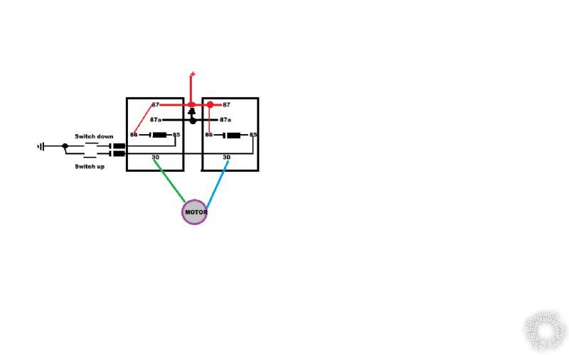

This show NEG switching which was the proper way (failsafe) to do it initially:-

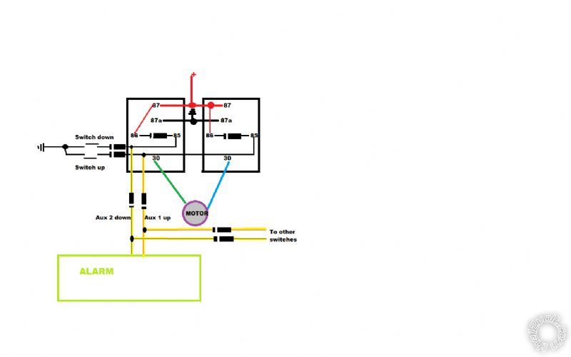

Now see how much simpler it is with NEG switching:-
The diodes shown are mandatory. (1N4004).
