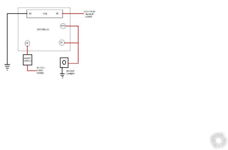

1986 Honda Civic fuel injected hatchback with simple ECU. Adding a Garmin Nuvi 2798LMT navigation unit with backup camera. Having read multiple rewiews of this particular unit, it appears that installing a relay alleviates some issue that the camera experiences in obtaining its power from the backup lights. As I also travel with an overhead DVD player which, when in use blocks my rear view, I would like to be able to use the camera as a rear view mirror replacement at my discretion. I would appreciate any input from the forum in regards to my planned install as indicated by the drawing below. Thanks in advance for all knowledgeable responses!
Wiring for Nav unit backup camera -- posted image.
