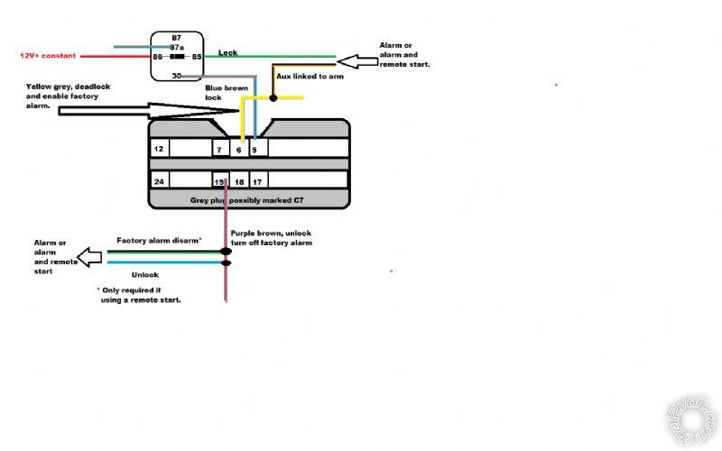

Wait I'm doing a diagram that might help.
Posted: June 28, 2015 at 2:03 PM / IP Logged Link to Post Post Reply Quote howie ll
This is difficult because here in the UK we're on V7 of the Fiesta and V4.5 of the Focus.
According to Directechs this grey plug should be on your CEM module.
Depending on spec and alarm/RS this will give you ignition lock/unlock if programmed and deadlock + factory alarm/release deadlock/factory alarm disarm:-
