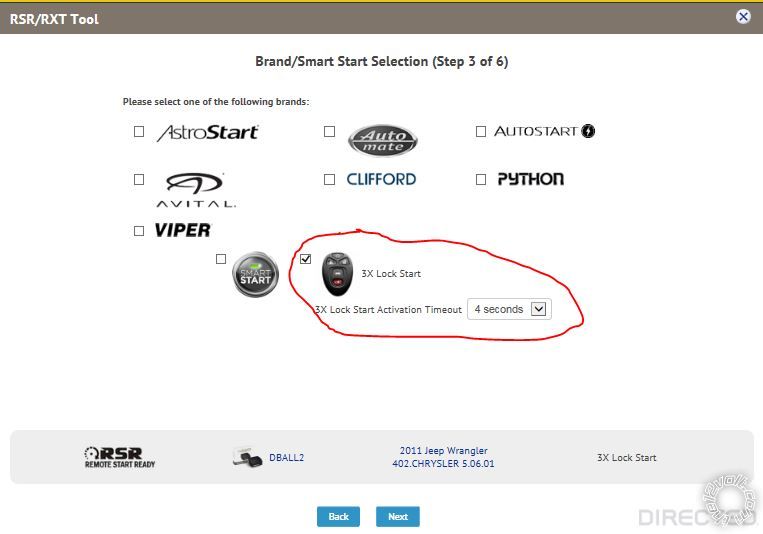

It appears to me that the RSR is no longer supported by DBALL2 and that either the XL202 or the Smart Start has to be purchased?

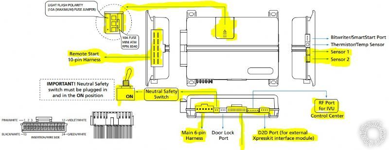

Everything is working for me except the remote start... I have switched the 5706 into automatic mode VIA the menus and I get the 8 alerts indicating "Neutral safety wire has no ground or the neutral safety switch is Off" when I attempt to do remote start.

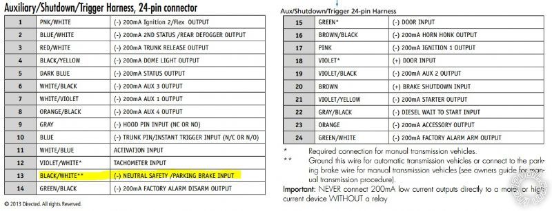

I have verified the safety switch is in the on position and that the BLACK/ white wire from the 24 pin aux harness is connected to ground with all my other ground wires.
Any ideas what I am doing wrong? Been beating my head against the wall for 2 days. Wiring information below.

Items below are what I connected
2011 Jeep Wrangler 4D w/ Viper 5706v & DBALL2 -- posted image.
1. +12v constant from battery
2. Ground
3. Siren red wire
13. Ground
2. +12v constant from battery
5. +12v constant from battery
10. Connected to pink/white wire in the 8 pin ignition harness
Door Lock, 3-pin connector
Not Used
I am using the D2D port to a DBALL2 flashed with a standard install
Sensor 1 = Shock Sensor
Sensor 2 = 508d proximity sensor

I would start with testing the switch. Make sure you have ground on both sides of it.

The only thing I see wrong with your wiring is your use of the Vipers' Pink/White IGN2 Output wire for the connection to the CHTHD2
( R9 - R10 ) t-harness Pink wire. You need to use the solid Pink IGN1 Input/Output wire from the Viper for that connection.

8 flashes is the neutral safety.
Check that the BLACK/ White aux harness 24-pin is grounded.
Also that stand alone witch is grounding when turned on.

BTW the 3x RS is back as of yesterday. LOL
https://www.directechs.com/news.aspx?newsid=24
Yea, verified that like 10x no joy..
Seriously... this wasn't there yesterday... Arrrrrr.. will try again... let you know.

IUVR&^#(&*
It works now.............. Thx guys... Very frustrating....
