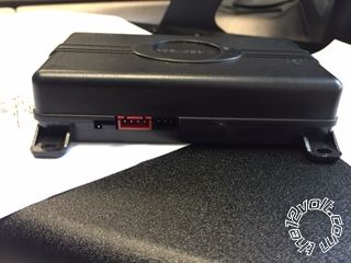

I had my friend send me a Pic of the unit, The D2D wire is in the correct port. Maybe it's not in the port all the way. I will have to check that, but I think it may be a long shot..

There appear to be two variations of the 4105.  Can you post the picture of the D2D port?

Posted: July 27, 2015 at 12:20 PM / IP Logged Link to Post Post Reply Quote jhughley
2007 F150 Bypass-can't get to program -- posted image.
Here is the requested picture. sorry it took so long.

Platinum - Posts: 7,827
Posted: July 27, 2015 at 8:23 PM / IP Logged Link to Post Post Reply Quote kreg357
Kinda hard to tell but it looks like you have the newer style that has an ESP port and the separate D2D port.  I don't believe that this
style unit needs to have the D2D port set to D2D vs ESP2.
If it still won't program, try doing the Type 1 routine at Step 4.
