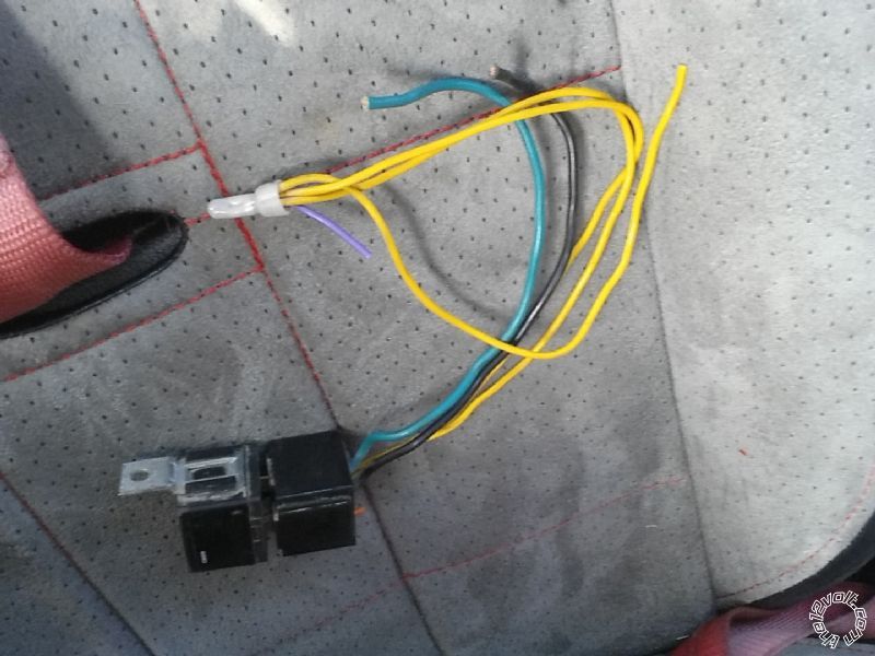

dismantling python 750 from 95 Wrangler -- posted image.
Ok finally. I had to use the selfie camera to make the file size small enough. Here is the directed electronics 610t relay. The black wire and the green wire are now going to the 2 ends of the yellow wire coming off of the ignition switch. The yellow wires that end in a purple wire eventually went to a blue wire under the dash. It was just tapped into the blue wire, the blue wire wasn't cut in half. The local installer suggested ignoring that for now.

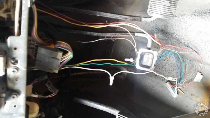

Posted: August 20, 2015 at 10:24 AM / IP Logged Link to Post Post Reply Quote mightykc
Ok, so the two ends of the wire attach to the two ends of yellow wire coming off of the ignition switch that I tested with a multimeter. The purple wire is the other end of the purple wire from the relay. The pink wire was my attempt at hot-wiring it by going directly from the yellow wire to the starter solenoid, which did not work.

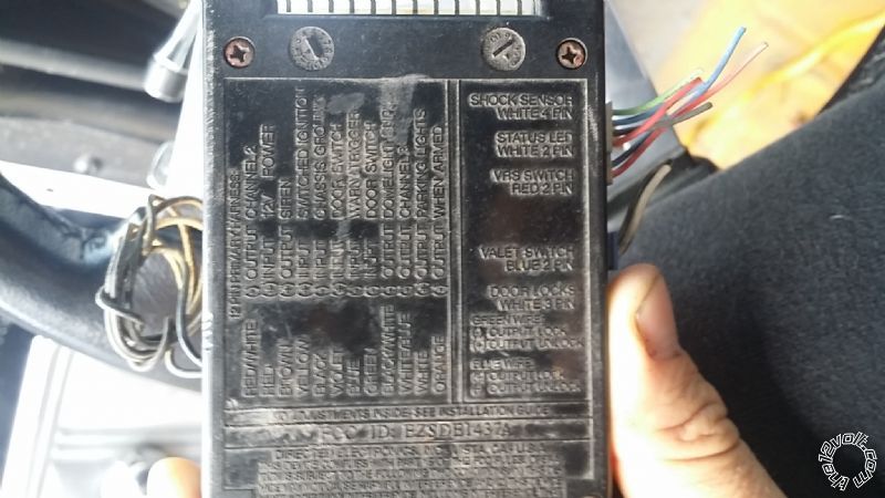

Here's the back of brain box of the alarm. It didn't have the VRS so that shouldn't be a factor. I'm not sure what other wires could be part of the problem now
Posted: August 20, 2015 at 10:30 AM / IP Logged Link to Post Post Reply Quote howie ll
Throw away the meter and use a test light you won't need it and that vehicle The blue and black on the relay, just rejoin where you removed it.
You don't need loads of pictures, any cut wire rejoin, any joined wire cut away.

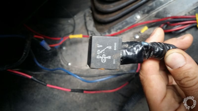

The other wires currently look like this. I'd rather not deal with them today unless I have to get it running. What would be the best way to deal with these? I'd almost have to take the dash apart to fish them all the way out. Eventually I'll have to clean it up, along with wiring from other modifications

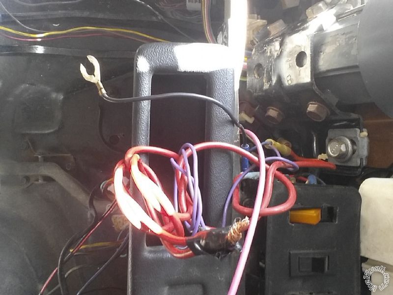

Posted: August 20, 2015 at 10:37 AM / IP Logged Link to Post Post Reply Quote mightykc
Waaaaiiit a minute... I've messed with this several times over the last few weeks and I just realized this other wad of wires has the same markings as the relay I think I have handled. Why do I have 2 of these? The other stuff I've read on the Internet no one has mentioned 2 of these
Posted: August 21, 2015 at 12:57 AM / IP Logged Link to Post Post Reply Quote howie ll
2 cut circuits same rules apply, trace back and make good.
You're making a right drama from a simple job.
1) Trace the wiring.
2) Make good i.e. rejoin any cuts.
3) Any joins, cut away the alarm wires, re-insulate.
Throw away your meter it's wasting time, use a test light.
