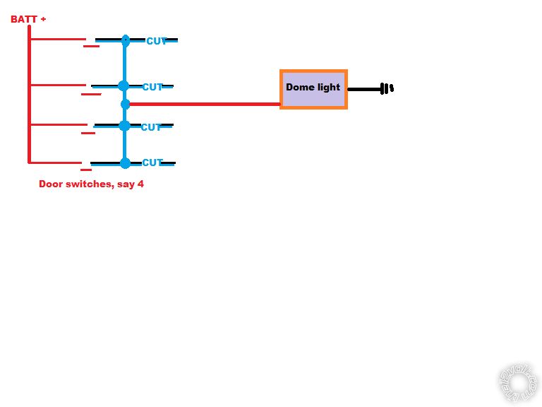

Posted: September 04, 2015 at 11:52 AM / IP Logged Link to Post Post Reply Quote howie ll
You can only delete the door handle part by cutting the wires to the lights, either inside each door or where they enter the vehicle.
I'll draw you a basic circuit.
BTW you're in a minority of 1, most people want the feature!
Posted: September 04, 2015 at 5:44 PM / IP Logged Link to Post Post Reply Quote howie ll

Posted: September 04, 2015 at 6:12 PM / IP Logged Link to Post Post Reply Quote eddyline
Thanks, Howie,
I understand lots of people like it. That's cool. I just wish it were controllable. There are many times I don't want to "broadcast" to the world (or the dark campground) who I am and what I'm doing.
Anyway, I can live with the door handle part (the thing where you touch the doorhandle and the dome lights come on, but then go off after X period of time. So since that's fraught with problems, I'll just let it go.
So that leaves two things:
1) If you have the doors open, the dome lights are always on drawing power. So you can't just have the doors open for an hour while you're doing something, or whatever. The dome lights won't shut off.
2) When I get in the dome lights come on and stay on until I put the key in the ignition. Therefore I'm always "telling everyone" that I'm traveling alone, plus my night vision is ruined.
Again, I'm all for the feature, no problem. My issue is that you can't NOT have these things happen. Or at least I have found no way.
I do very much appreciate your help!
Eddy
