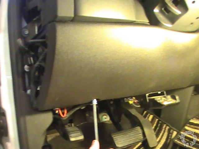

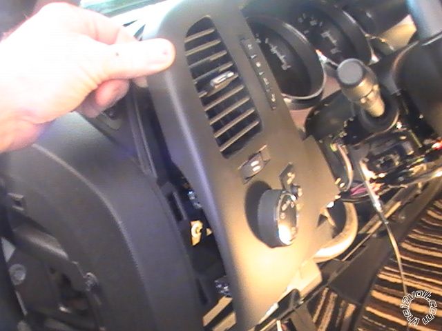

Lower Dash Panel. Two screws and one 10mm bolt on bottom, then three clips hold it on.

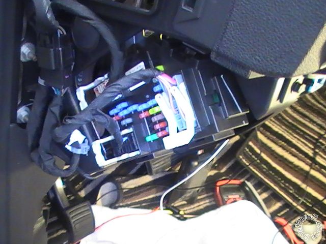

Fuse panel, fuse box, and back of fuse box for 12 volt connection.

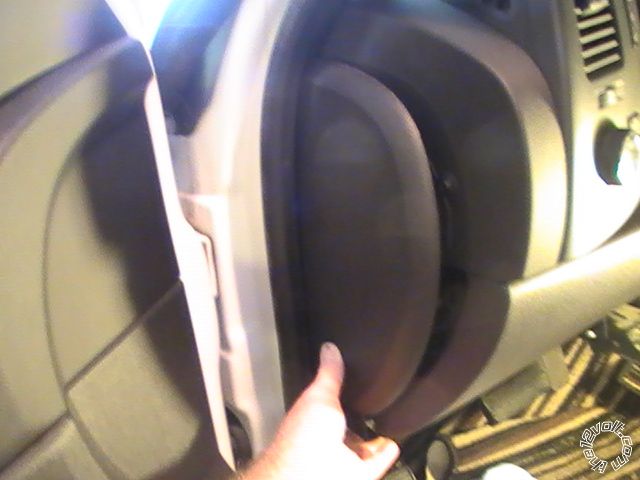

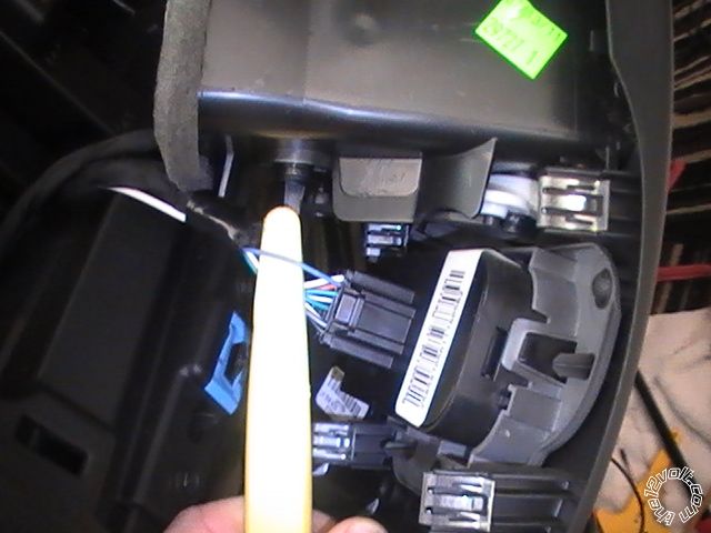

Headlight panel held on with five clips and Parking light wire.

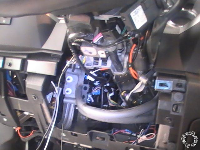

Under dash area. Fair amount of room.

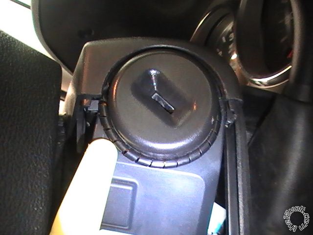

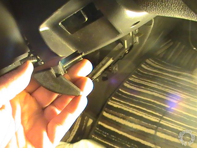

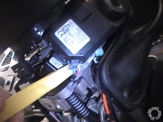

Tilt Wheel Lever pulls out to remove lower steering cover for access to Ignition and transponder connectors.

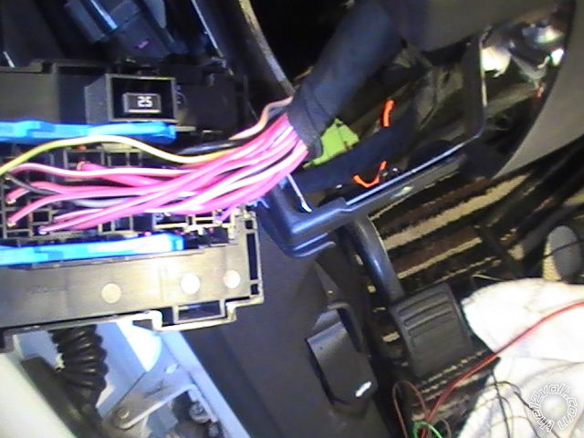

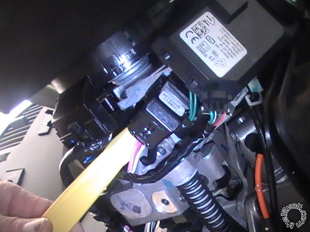

Ignition Connector and Transponder connector

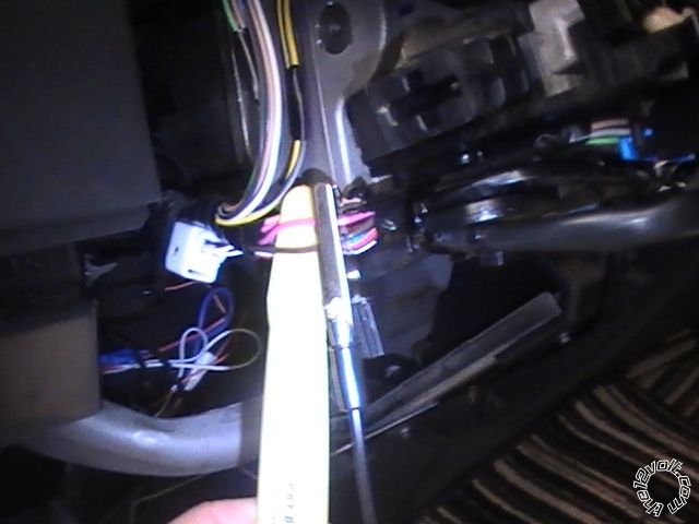

Ignition Wire(Pink), and Accessory Wire,(Brown)

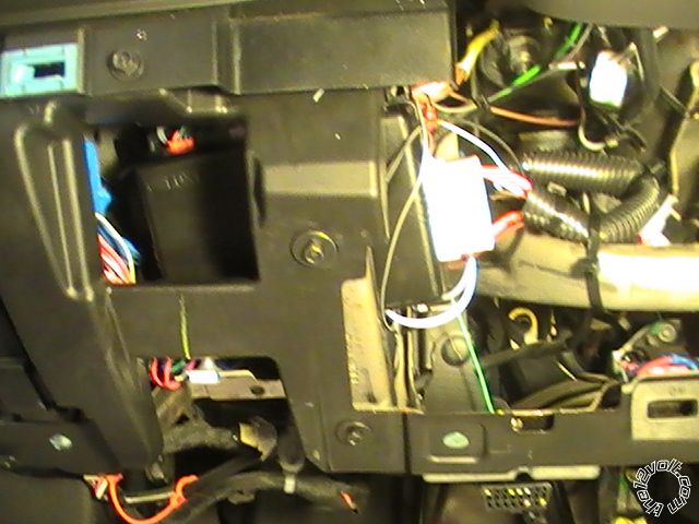

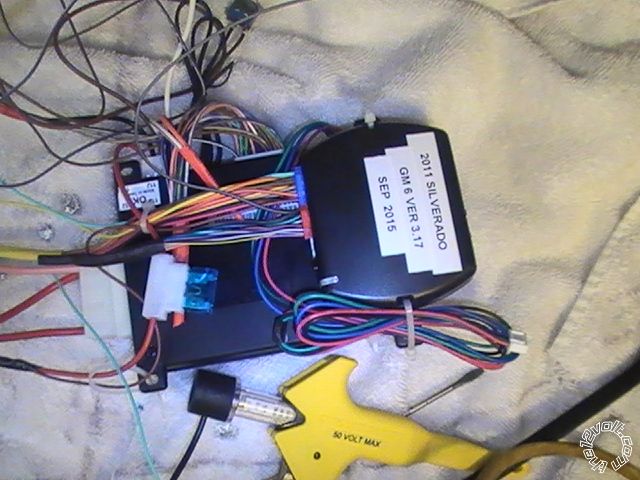

RFLCHGM cable loop around Key cylinder. Tightened with a small zip tie.
All tucked away.
