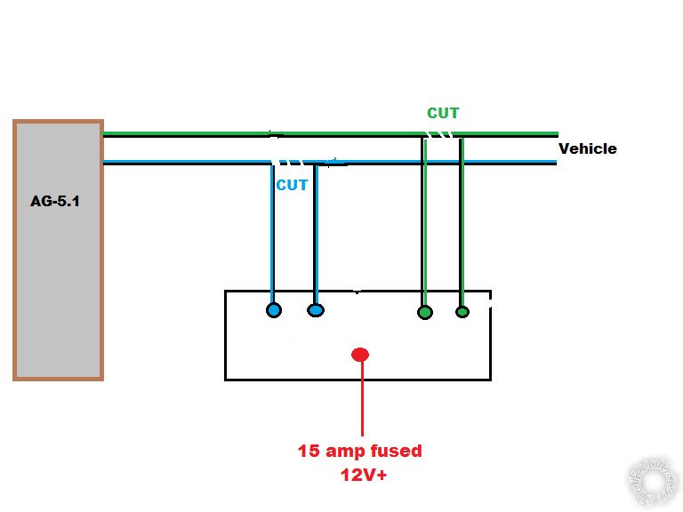

Sounds like the locks are aftermarket as well.
5 terminal SPAL window switch, or this http://www.newark.com/eaton/2606-11e/switch-rocker-dpdt-10a-250v-BLACK/ dp/94F8150?MER=PPSO_N_P_EverywhereElse_None but you'll have to contact Farnell to ascertain that it's momentary.
No diodes or relays required.

Posted: September 22, 2015 at 2:30 PM / IP Logged Link to Post Post Reply Quote kenjune
Been trying different scenarios for unlock and locking manually. Started by trying a spal/momentary switch. keep blowing fuses. Tried using diodes. They don't allow the locks to complete the loop. I am considering using a remote keyless system along with the Avantguard 5.1. Is there a way to use them both independently without interfering with each other. Thanks Ken
